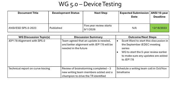

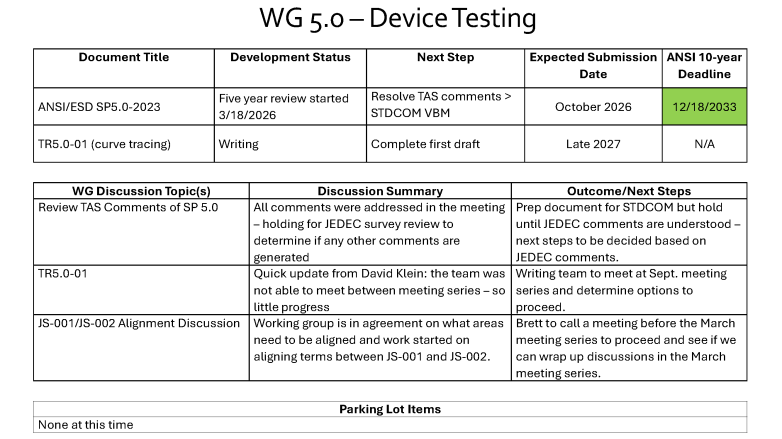

    • Use of curve tracing in place of ATE during characterization
      • Many use curve tracing during characterization, rather than ATE but there's limited information available on interpreting curve tracing.
      • WG decided information is needed and a TR should be developed on curve tracing. A writing team was identified.
        • Start as a TR and then discuss as to whether this would be folded into the individual User Guides.
      • Action item: Develop a TR highlighting when it’s useful, how to perform, how to avoid causing damage and how to interpret results – Brett to kick off the first call and identify owners.
    • Review of failure criteria within the JS-001 and JS-002 docs
      • Terms are different in the documents and don't really cover all scenarios.
      • WG spent time in the meeting to modify the failure criteria – after the final WG review, this will be used in both JS-001 and JS-002.
      • Action item: Brett to send out the suggested change options for the failure criteria for WG vote.
  • A consensus was reached on adjusting language regarding the interchangeability of CDM units for HBM testing and vice versa—identified text in JS-001 and JS-002 requiring modification or removal. The decision will be forwarded to both JWGs for integration into the upcoming JS-001 and JS-002 updates.
    Lengthy discussion on failure criteria in JS-001 and JS-002, exploring the feasibility of offering more guidance. Consideration of a Technical Report (TR) for additional direction, as no further information can be appended to JS-001 and JS-002.

  • The WG adjudicated the industry review comments on DSP5.0-2023 - “Reporting ESD Withstand Levels on Datasheets”.
  • The WG discussed possible updates to SP5.0 – “Reporting ESD Withstand Levels on Datasheets”.

  • The WG addressed final TAS comments on WIP5.0 – “Reporting ESD Withstand Levels on Datasheets”. The document is ready for STDCOM submission.
  • The group completed the five-year review of ANSI/ESD SP5.0. There was also a discussion on how die-to-die interfaces are handled regarding ESD targets and testing.
