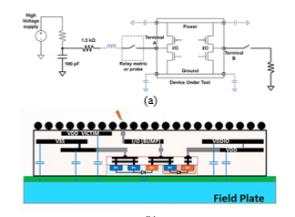

An HBM ESD source is typically modeled as an equivalent lumped circuit to produce the exponentially decaying current pulse (Fig.1(a)). A CDM ESD source can be similarly represented, or by an array of capacitors attached to the IC in a distributed manner to model the field coupling from the CDM tester (Fig.1(b)). A behavioral approach is also applicable, such as using a damped sinusoidal wave to simulate CDM current pulse.
An ESD event is most comprehensively simulated through whole-chip transient simulation with nonlinear ESD device models. However, such simulation is traditionally resource-intensive and time-consuming. Simplifications can be made to improve simulation efficiency, with trade-offs in accuracy.
Fig. 1: (a) HBM ESD simulation test-bench. (b) CDM ESD simulation test-bench.

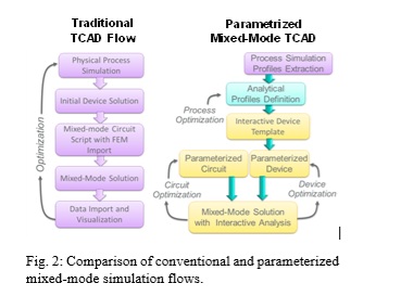

TCAD applications are effective at the technology and ESD IP development stages. One of the most important representations of a TCAD approach for EDA is mixed-mode simulation, which extends transient simulations’ capabilities from a single device structure to several devices within small circuits (Fig. 2).
